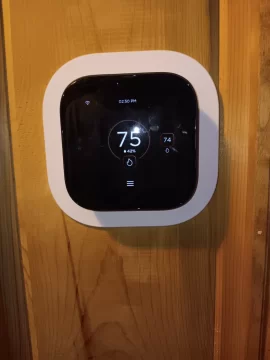

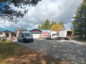

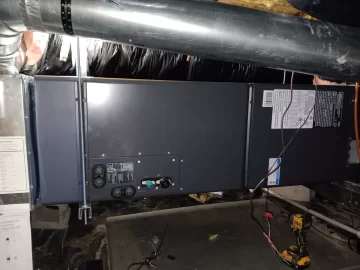

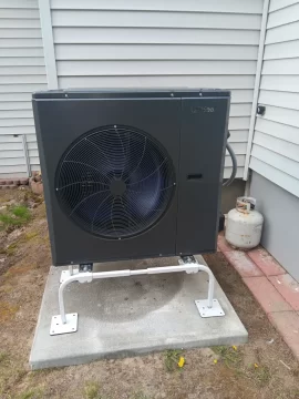

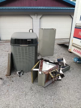

It helps a little. This year we replaced Heat Pump with one that works down to -20f. Have HALO Led on it and Washable Metal 4" Filter. Really have noticed dust reduction now. Midea Evox G3 System. Out with Old Trane XR13i (From 2001) to New. Seems like stellar unit, half or less of the noise outside. Tons better dust collection. https://neverbuyanotherfilter.com/

Not enough Data yet to make determination. But it seems to save about 1/4 of our previous Electrical Use over old unit so far. Will take a year to get REAL Data.. 40kw yesterday and 50kw today (Cooler).

I haven't found any dealers listed yet but there should be some in the Seattle/Tacoma area. How did you locate a dealer out in Newport?
Called Around. Found one in Spokane. NORCO. So far it's great. Winter will be real test. 509 534 4075 norcoha.com They are out of Spokane. Not much up here in Newport WA.
