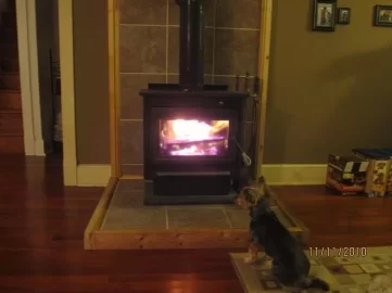

After looking around for like 2 weeks for a pad that we both liked and not finding one, we decided to build our own. We put out no more than $250 in materials and we both got exactly what we wanted. I got a hearth that doubles the recommended R value and she got a hearth that matches the color scheme perfectly.
