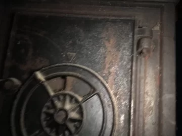

anyone know what this is?
Purchased in 70s I believe but not certain

No name or number anywhere that you can find?
Sorry the pics suck....it's under the basement stairs so I could not get to it very well.

Looks like a cool stove, will be interested to see more pics. I'm betting someone here will know what it is.
Yes, looks like a Scandia knockoff of the Jotul F118. Some of these have Made in Taiwan on the back at the bottom of the casting. I also thought of Trolla, but they usually had their name on the front.
