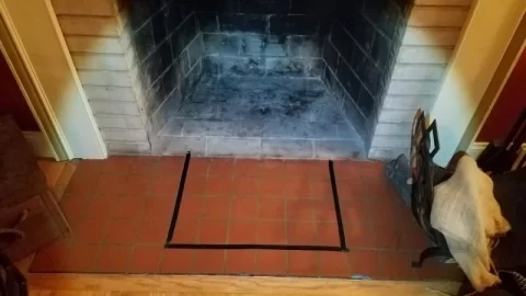

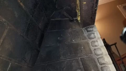

Here are some pictures. The height of my fireplace is 30" in the front opening. Would it make sense to open up the brick in the front? I also have a picture of how far the Englander NC30 will stick out. (I am planning on building a new hearth to meet clearance to combustibles.

Mantel clearances and working room to connect the stove are a concern. Have you considered a budget insert like the Englander 13NCi or the True North TN20 insert?
I have never been a fan of inserts, I have always been a standalone stove kind of guy. with the collar height of this stove coming in at 29.5, I am planning on cutting the feet which I know a few people on this site have done to the NC30
On the Englander NC30, there is no mention of mantle clearance, but I am planning on removing the mantle that is there anyway, so it shouldn't be an issue.
An insert often is the same as a freestander that has been designed with a flat bottom that will not interfere with the air controls and a convection top so that heat is not wasted from the top. Very often, the firebox is identical to the company's freestanding stove equivalent. To improve the efficiency of the 30NC in this circumstance look at the convection deck that Highbeam put on his 30NC.
