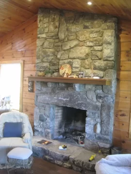

Here's my living room fireplace. Kitchen to the left. The whole room is 14x24 or 336 sq ft. The vaulted area is another 3.5 ft, so the volume is equivalent to not quite a 10 ft ceiling.

Very nice looking fireplace. I can see why visually you might prefer a freestanding stove. Inserts that project out onto the hearth, as opposed to flush, can do a decent job of heating during a power outage. They are less dependent on the blower. The issue during an outage will be the heat stratifying at the ceiling peak. Some inserts look better than others without the surround. You could also get an insert and make your own custom surround that sits fits tightly to the fireplace opening. This could be made out of expanded metal if you want to recoup some heat that is normally trapped behind the surround.

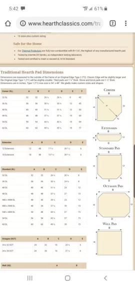

Or just get a nice hearth extension, like these from Hearth Classics...
