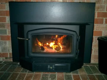

Hi,
Ok.. I have a new Regency i2400 (medium sized wood stove insert) in my fireplace on the 1st floor of my 2 story house.
The chimney is external to the house -- goes along the side of the 1st and 2nd stories and ends a little above our peaked roof and was newly capped/screened when the insert was installed.
The chimney is lined with a 6 inch flexible steel liner tube which is directly connected to the stove.
The first time I fired up the stove it did smoke a bit at first, but I did this on Dec. 7th (when it was still not too cold in Maryland -- where I live). So after watching the smoke roll around in the firebox for perhaps a minute or so, it then cleared as a decent upward draw / draft established itself and then kept going. Then later on I added another split or 2 and had a decent fire going as you can see in the attached pic of the stove.
Ok, now it's Feb. and a few days ago (at night when it was more cold -- perhaps 20's or 30's), I tried building and starting a fire, but that time again the smoke rolled around at first in the firebox a bit, but the downdraft from the cold air in the chimney was so strong that after a minute the smoke was actually being forced out the 2 vertical intake vents that are on either side of the stove. It's really kinda distressing to watch smoke streaming out of those vents into the surrounding room and I wasn't sure what to do -- fortunately the newspaper I'd lit soon went out (perhaps due to the cold) and so the smoking stopped. But boy it's a pain to have to then open all your windows and fan out your smoky house.
Perhaps I had built that fire a bit poorly... I'm not exactly sure since this is my first time with a wood stove insert. With the fire that smoked I had 4 or 5 balled up pieces of newspaper under some pieces of fatwood and a smaller split and some bark pieces (for kindling) placed across the fatwood. I think part of the problem was that the burning newspaper balls (which generated most of the smoke) had flames that were mainly only hitting the split on top -- so of course it was not enough to catch it on fire and that made a bit more smoke to add to the newspaper smoke... next time I was just going to try to burn a small fatwood stack as explained below:
Anyway, ok I read on here some of the techniques to try to deal with a cold down draft in a cold chimney:
* tried first opening the door of the stove for like 40 min. or so to let some warm air up the chimney to at least reduce the total volume of cold air in the chimney
* opened a nearby sliding door to the outside to let in air to prevent negative pressure in the house
* tried lighting a stick of fatwood and held it in my hand to wave near the opening in the top of the stove that leads to the chimney to establish a small upward draft -- when doing that it worked for a while but actually after a little while the downdraft even blew out the stick of fatwood (perhaps I held it a bit too far up and the slight downward breeze was a bit too strong). I have a friend who uses a "torch" of rolled up newspaper -- waves it up in his flue and then lights his fire with that... maybe newspaper would work better, but it seemed like it was the newspaper that was mainly generating the smoke the last time the smoke came out my vents, so I'm not sure I should use paper.
* I've also considered maybe trying supercedars since that should not smoke as much...
So, I'm not really sure about what to do to be able to start a fire fast enough that I can avoid some smoke being forced out my vents before a fire can catch enough to establish an updraft. If it gets fairly cold outside is it not possible to avoid a fair amount of smoke being forced out your intake vents??
I was going to just try lighting a little pile of fatwood sitting in the middle of the firebox hoping that would smoke less than the newspaper from before and that it might be enough to warm it up and create a little updraft so that I could then add some larger kindling... and then later add a real split piece. Is that a good approach?
I was even considering maybe first lighting the fatwood and then trying to blow a warm hairdryer up the chimney for a bit to see if that might help.
Well I'd appreciate any advice about how to get a fire going quickly enough to establish an updraft fast enough so that smoke doesn't have to be forced out into the room -- or at least maybe only a small amount of it, if that is unavoidable on a cold day.
Thanks for any help / ideas!!
--Matt

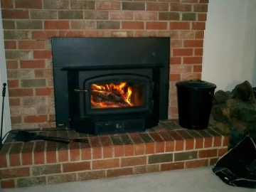

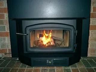

I just lit a chunk of that StarterLogg stuff that I bought at Safeway. I took a brick of the stuff and broke off a piece about the size of a golfball and boy does that stuff burn!!
What is *great* about this stuff is that it burns CLEAN, continuously, and vigorously.
It seems like the perfect solution for me... mainly that there is *no smoke* at all. So I can just light the thing and wait for the heat build-up to reverse the draft for me.... beautiful.
The chunk I'm burning right now is just blazing away beautifully...
Thanks so much!! :)
Robbie said:
Ceramic heater placed in the door of mine for about 4 to 5 minutes works every time for me. I had a few smoke outs when my pipe was cold, but not any more.
Stack kindling in ready to light, then place heater in door for a few minutes, then light..........remove heater.
Robbie
I also like this idea... I have a nice little portable heater that I can try for this purpose... also might try the hairdryer concept...
But boy, just burning a golfball sized chunk of StarterLogg fire starter brick is burning like crazy and so clean that I think, even if I had the biggest downdraft in the world, that it wouldn't matter 'cause the thing doesn't generate any smoke at all!!... man it's SO much better than fatwood.
Right now it is 33 degrees where I am in Maryland and no problem at all in the chimney so far... when this little chunk burns out then I'm gonna quickly build a small fire using a bigger chunk of the StarterLogg stuff.
Thanks to everyone for all the help!!! This is a great community!! :) The way the internet is meant to be... ;) :)
Last year was my first year and my first few fires smoked the place out. After a friend showed me how to get a good flame going on start up, it hasn't been a problem. Getting the confidence to keep building the fire up when you see a little smoke takes time.
Yeah.. makes total sense!
Hey, guess what tho', with those StarterLogg fire starter brick things (and I'm sure SuperCedars are even better, from what I've read here), I get NO smoke at all... I mean virtually zero... can't see any at all.
And THAT gives me the confidence to start just a small golfball sized piece to create a draft... I did that, then pushed the small coal it generated to the back of the stove... Then I built a medium sized structure out of 3 small chunks of StarterLogg, and stacked a few pieces of my extra fatwood on top of that, and a slightly bigger piece of kindling... that thing went up like a rocket! Once that was going, I put on a couple larger pieces... and finally 2 giant mac-daddy pieces... and attached to this post you can see the fruits of my labors!
The Regency i2400 is burning like a champ... I guess their design is pretty good after all, once you know how to use some non-smoking kindling ;).
And the automatic blower is just *pumping* heat out into the room...
Anyway, it's a thing of beauty!!
Deepest thanks to everyone on here who helped me!!! :)
