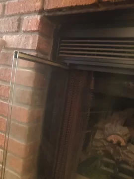

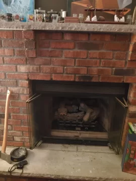

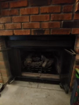

Post a picture or two. If it is a ZC fireplace, look for the make and model in the door frame and post that here too.
Can't find a label. Here.
[Hearth.com] Wood Stove Insert for 800 sqft [Hearth.com] Wood Stove Insert for 800 sqft [Hearth.com] Wood Stove Insert for 800 sqft
Yes, and that would rule out a freestanding stove tapped into the chimney too.
Revisiting this, what does zero clearance mean?
A "zero clearance fireplace" is a prefabricated unit that goes in a framed opening. Then a prefabricated (usually air cooled chimney) specified for the unit goes ontop of it and out the top of the framed structure.
