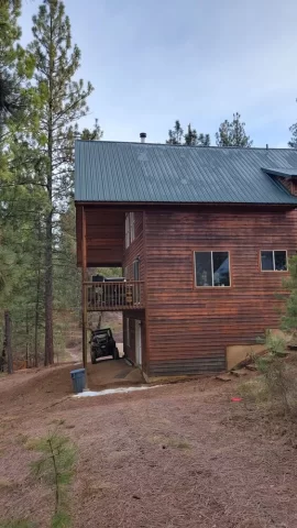

We purchased a house this spring that had a freestanding wood stove, I attempted to get the pipe cleaned this fall and that's when the issues came up. I live out in the woods about an hour from a city, there is one local guy that cleans chimneys. When he came out he said the roof was too steep and he would have to clean from down below. When he lifted the sleeve on the pipe that was on the stove the pipe wasn't attached at the ceiling, the entire 24' of pipe almost fell in my house. We got the sleeve back down on the stove, he put a couple screws in up top, and left, and I have spent the last 9 weeks trying to get help with no luck.

Even if I get new pipe I can't find anyone to get up on my roof to clean the pipe. I have called 37 companies ranging in a 6 hour drive to my place and nobody will get on my roof after I send them pictures, of those 37 I got 3 to come out to my house and they said no.

How steep is your roof?
What is scaring them?

Ok. I see why they'd pass. It'd take some time to set up to be safe. There are plenty of easy roofs to do.
So, the first thing I'd do is see if the telescoping section on the pipe is just stuck with creosote to the singlewall. If the two were stuck together you could lift the chimney right out of the ceiling support box, which normally supports the chimney. I'm not sure when Earthstove stopped making stoves, but none that I've seen were newer than EPA regulations. It wouldn't be hard to fuse them. If thats the case, you could cut the old single wall off and then install new pipe.
If the chimney support box is supporting the chimney you can clean the one you have from the bottom.
