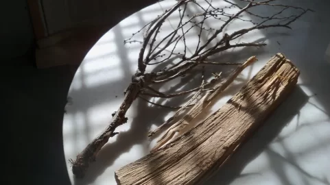

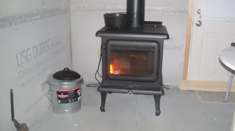

My porch is freezing so I am going to light my wood stove again (J.A. Roby sirius). But i have some questions...I picked up a branch of honey locust that fell in my yard from my tree and it's dry and can I put in the whole branch as well as I split this other wood as kindling with a ax (lumber jack time)--can I put that in the middle of my wood stack in the stove and use that for kindling as well...For the wood stove load do I have too much and my walls of the inside part of the stove is black on the sides do I need to clean that because I rubbed my finger on it and its black ash. Just wondering before I light the stove and take some pictures..One more question--would this be considered a NS wood loading with my stove...? Pictures of what I am talking about here...Those walls inside looks like they are peeling or something--should I clean them or scrape them? clancey
[Hearth.com] Wood stove lighting once again [Hearth.com] Wood stove lighting once again [Hearth.com] Wood stove lighting once again
Everything you are asking about is fine to do, the walls are fine as well. It will just burn off. Nothing wrong with burning small branches like that in a stove just make sure they actually are dry. Honey Locust for me isn't the best at starting up but a dead branch is likely easier than a full size split.
Thanks and here I go and I will light it up as well as try to time it to see how long this amount of wood burns without replacement and when my blower turns on as well...I might even heat up a pot of soup and have some irish coffee--yes---I will take some pictures of the fire too..clancey
Given the buds on the branch, I'm not convinced that it is dry ..
Well that's one thing to consider--buds...you would think they would make it burn better..thanks..I have some more pictures and my soup is not hot yet...clancey

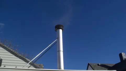

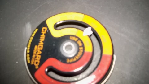

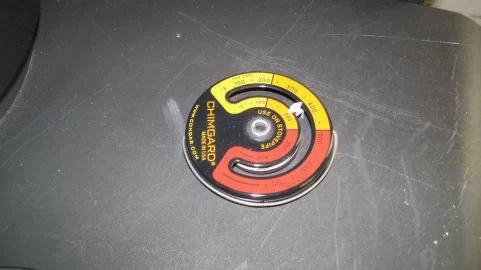

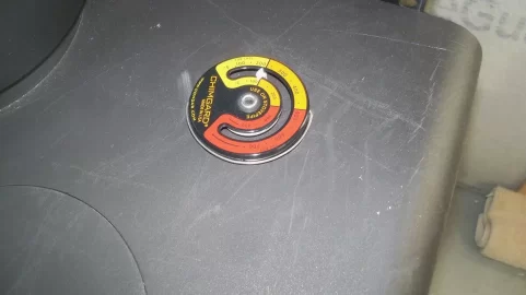

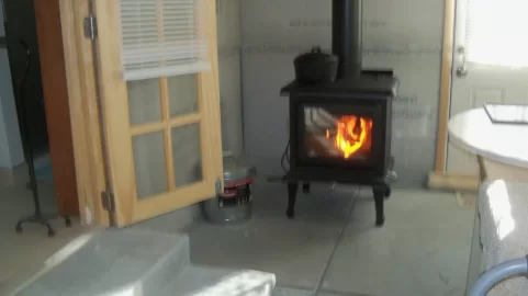

It's on its way and now I am waiting for the soup to become hot and the temperature is 300 with the (thingy) all closed and it was open to about 1/4 of the way...My parakeets in my back room are feeling some of the heat for they are chirping happily...When it gets real big and my blower goes on I will take another picture--thanks marty and everybody..clancey

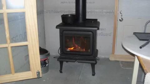

Ha--yes nice and warm...It took awhile and after 1 hour and 15 minutes from starting my veg. soup is hot enough--yes I hungry..Last pictures I took was five minutes ago and I will share them with you. My blower keeps going on and off and this has happen twice..Wish you all were here for I have home made veg. soup and irish coffee...Yes...enjoying the stove and radio music...and my soup.. thanks panderson03 and everybody..clancey

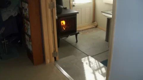

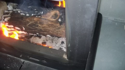

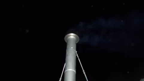

Ah all my flame went out and just red coals and had to open up the door and move things around to get more flame...Is this normal...its burning now but the blower is off and has not turned on again and the temperature is still at 350 with not a lot of smoke coming out the chimney outside.. Now its burning nicely again...clancey
Everything burning nicely and temperature is maintaining at 350 and the blower turned on again..I think that I like putting in the firewood from left side to right side and putting the kindling under those logs to start from the bottom up instead of putting the splits from the back to the front and lighting from the top--it seems to stay lite longer the other way left to right...easier for me to prop up one of those splits for air from the bottom...Now is this way east to west? I think that I like that way better and my glass does not get as dirty if I keep it to the back..I read that this way the splits could roll and break the window and is this a concern...I love my stove...clancey

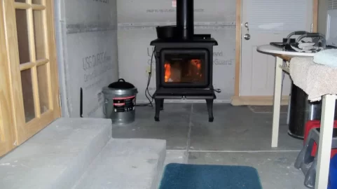

Well stove has been burning almost six hours and so far I have used in total five splits of kiln dried 16 inch wood and my heater is off and my kitchen is maintaining 70 degrees with the back of the house about 60 degrees and its about 35 degrees outside with no wind or snow.. The fire went out one time and I moved it around and it started again but had to put some more kindling underneath the left log to get it to burn and I added another split just now on top of the wood..The temperature is 325 and burning nicely with the blower on..The room temperature gauge has a lot to be desired and it is 40 years old on the electrical outlet and reads 70 degrees in the kitchen area...pictures coming clancey..

Thanks it's still going and I decided to make myself a nice salad to celebrate..lol Now all I have to enter is how long it keep burning and how long it kept my porch warm..(no heat in the porch) but lots of insulation in the floor, the walls and the ceiling but it has two doors and three windows so we will see..The last piece of wood is burning now and I am just going to leave it go out now as well as timing it to see how long it took..Thank you everybody for the support and help...This burning wood makes you hungry but warm...picture..clancey

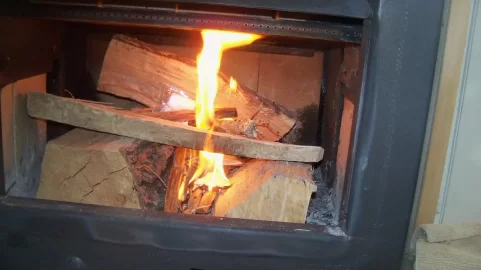

You do have to be more careful with E-W loading. As you read, it's possible to have something roll towards the front of the stove. N-S loading doesn't eliminate this of course but it makes it less likely as you will probably only have the risk of the burnt down end of a log being able to fall back against the door or through the opening while you're tending the fire.
However there are tons of stoves designed mostly for E-W loading. I'd say it's not something to lose sleep over but just be aware of it and don't precariously balance a log on top of a pyramid of other logs, as it could roll towards the door.

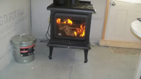

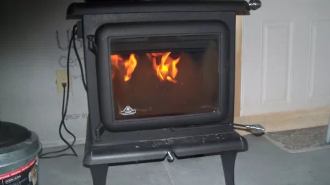

Looks like your window is smoky and 350 is not hot enough, that's what I use to maintain a coal bed and keep the fan running with maybe 3 splits. From your pix, I would use that small E/W stick on the bottom first to help get air, then the others N/S, and pack them together, even add another couple or so. My cruising temp is 650-700, so don't be afraid of that. After you get everything going good, shut bypass and adjust air, you should not even see a whisp of smoke coming out the stack. Fan should stay on all the time, if doing on/off then it's telling you time to reload and get another hot fire going.
Nice information --thank you....I will try all of that next time that I do a fire and see if it makes a difference...I am also going to call the fan blower company and ask them for some kind of user information for I never got any and it does go on and off usually starting about temp. 325 so I will check that out further..Was going to light a fire tonight but changed my mind because of such high wind and fire troubles in the Boulder area--smoke coming here at times and the sky looks terrible. Put my birdies inside early just in case the wind gets stronger--terrible..thanks so much..clancey
Reactions: Vg3200p
500* is probably about as cool as you can run a new load and expect a nice clean burn...once you get into the 6-700* range you will find out that lil stove can really put out some heat!

Put a good load in that thing! Betting you will get the stove temps that you want. 3-4 splits randomly layed in the stove ain't doing it.
Your experiance with the couple splits layed on coals is perfectly normal. They will sit and smolder/smoke excessively until sufficient heat is created to ignite.

Don’t be afraid to put more than 3 splits of wood in your stove for a load, and when you reload, consider three splits packed closely together as the minimum. The wood heat radiates from one piece to another and helps the load burn well. Think of how mittens keep your fingers warmer than gloves because the heat from your being together helps. The two pieces you put on your coal bed smoldered probably because they weren’t heating each other.
I know that you’re afraid of fire, but running your stove too cool and having smoky fires is going to be more harmful in the long run. These stoves are made to be loaded full and burned hot, and that hot burn helps consume the particles in the smoke that could condense in your chimney and cause creosote buildup. It’s that creosote buildup that could lead to problems with a chimney fire later. A chimney fire is a more likely danger than something involving the box of your stove.
Wood at 17 or 18 percent moisture really should not have a problem burning. I think fundamentally you just need to get comfortable with putting more wood in the stove at a time so that you get it burning hotter. Then when most of the wood is consumed and you have a nice coal bed, reload with another larger batch of wood. Three splits needs to be your minimum. (The exception to that is when you’re trying to burn down your coal bed, but I think we can save that discussion for another time.)
I’d also recommend that you not make your splits smaller at this time. They look like a fine size for the stove, and you don’t want to have too much small wood. What am I missing about why you want to cut it?
My wife was nervous about loading up our tiny Morso to the gills, but it actually burns better that way. Most stoves are designed to be loaded all the way to the top, not so much for small loads. I know this runs counter to your every instinct about making things last longer. Wood stoves are made for dumb men to load them full and burn them hot, you aren't going to have any problems if you are attentive.
