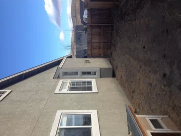

Ok, I've posted a few different threads before on this and I have one final location I'm thinking about.
It's going to take a little alteration but all of the spots I've looked at require it.
This is where a gas fireplace is currently at. It's 24" deep, with the hearth sticking out another 12". My idea is this, take the fireplace out, frame the top of alcove up to 9' and extend the hearth another 16" then put a nice stone on the hearth.
The hearth is 20" tall with another 87" to the top of it. It's also 84" wide.
My question is, will this support the weight of a cape cod lopi? 600 lbs is what it's said to weight. Also, I have to offset the chimney connector pipe to run the chimney up the side of the house. Can I use chimney connector elbows to do this inside the alcove?
Here are some pictures of the current fire place and a drawing of my idea.
Thanks
