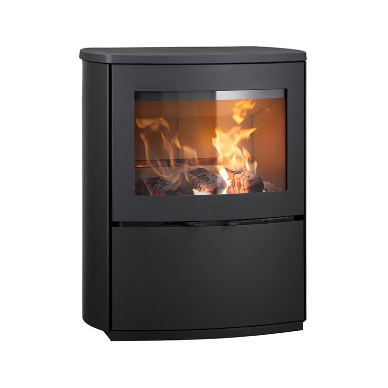

Sean in the woods, would you have considered one of these mini-meat masonry heaters when you were deciding on which way to go? I'll be the salesman. (You enter the store and a sales person approaches you) We have this Kube 4-2 masonry heater right over here. Let me tell you about it. It weighs just over 1000 pounds. It has chambers above the firebox. Of course it is beautiful and made of soapstone.
You can put it together yourself in an afternoon - it uses metal splines. Also besides the glass door you can order side glass viewing panels - as many as you want. Cost is $6,000.

I still feel like the firebox is too small for most American sized homes in cold climates, but they do look very nice.

Wait, it costs $6000 and you have to put it together yourself like an Ikea kit?

No. It is not large enough for our house. The amount of mass is not enough and the firebox only holds a maximum of 6 pounds of wood. Math tells me that the BTU input to the system is not enough.

It's an attractive, small to medium sized stove with a modest heat output (3-7 kW) that would be good as a room heater. Based on my limited experience in Scandanavia, they keep their rooms cooler and often only heat by area, not the whole house. It's not uncommon for them to keep the house around 65º and wear sweaters. Many of their stove designs are based on this. Some companies like Morso don't make large stoves at all. Frugal folks in the UK run even cooler houses in the winter.
Interesting. I think I would only need one of these mini-me heaters for my house (passive solar, high insulation, and small), but I could be wrong.
7kw is less than the smallest UL/EPA listed stoves in the US, that I know of anyway. Maybe a small mass heater would work well in a tiny house to have a long time between loading and not overheat the space?
Looks like the Kube 5 might be 12kw output. My only concern for a passive solar house would be overheating in the scenario mentioned earlier. With the small stove, it may not be a major issue, as long as windows can be opened.
