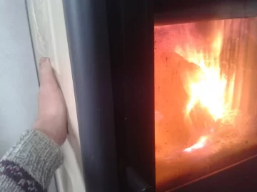

Another indicator to me that these are more acting as minor radiant heater, or as a convective stoves was how both videos showed people touching the stove. A real small mass heater with a fire at that level would get actually very hot to the touch (I know because my neighbor has a real mass "small" mass heater which is even larger than the stove in these videos, and it can get very hot). But a convection stove would not get that hot, as the air flow cools the external casing. Case in point, a photo of my hand on my convection stove, which despite the pretty tile, is not in any way a mass heater.
