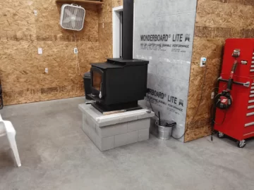

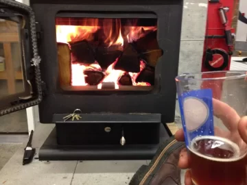

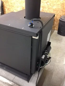

You'll love the NC30. I made some changes to mine to make it more like a furnace but it is not ducted. Much beefier blower, adjustable thermostatic control for said blower in the convection deck, made a convection deck for the stove top that really strips heat and blasts it out. I can go through a firebox full in about three hours holding 700 on the stove top.
Really, I should have bought a furnace but none were legal in my state. These days I know of one or maybe two that have gotten clean enough to be legal but they still aren't on our approved list yet. Soon.
And I paid 699 for my NC30! Plus 99 delivery, plus state sales tax, so almost 800$! Great deal.
