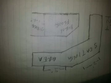

Okay, I'm planning my outside "fire pit" area. I'm wondering, any issues with getting a few old smoke dragons inserts and putting them on a concrete hearth and finishing around them so all you see is the inside with no door.
I am close to electric, so I can run electricity for the fans.
Here is a rough layout.

So I enjoy a diversion as much as the next guy. But my OP is really about getting a long coal bed in a horizontal, "pizza oven" type burn area. My sitting bench would be right across from it. See my original drawing.
I actually did not take that idea from the drawing.

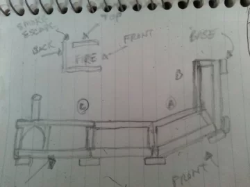

I was thinking more of a bluestone slab, 2x4 each, structure, low and long, so the warmth flows out at those sitting. Chimney in the back and maybe another at the end for a pizza oven.
[Hearth.com] Wood stove outside

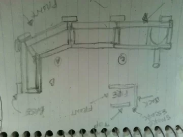

A quick drawing. I'm not quite sure the smoke escape gap at the rear will make an effective draw, but it sure will make a clean sleek look I'm after.
Flipped the picture.

Ultimately, the driving idea is that red hot coals provide heat, not flames. I want a long, low bed hot coals at sitting level, ideally, with a fan blowing out.
