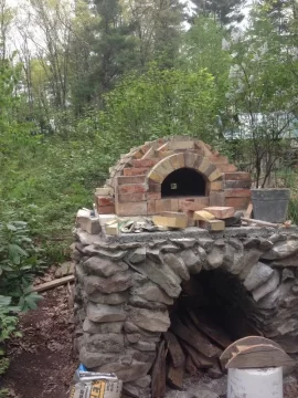

Here is the base (all stone/mortar) with bottom insulation and the floor of the oven. I have been busting my scrawny keester making this- well, the next one should be easier :) Lots of hobbit jokes floating around on this one.
I should have the oven smacked out by next weekend.

Pretty dang cool. Using a form is something I might not have thought about. Learn't something today. Now I can go home.

It should get pretty hot, but not to kiln temps. I was going to make a mini Japanese kiln, but it wouldn't have the same top/bottom heat distribution, so I went with this classic design. Chimney will be built today.

Awesome! I'm a sucker for stone work and dream of building a pizza oven in my backyard one day. More pics of the brick work please!

I take it you already have a "recipe" for the insulating castable over the dome?

I have a LOT of insulating firebricks- mostly broken- I pieced them together with an refactory mortar loaded with crushed insulating bricks. Covered the whole thing with hydraulic cement for some weather resistance until I can make tiles.
Jags- it's a good question. In very untypical style- I didn't measure. I thought about putting in a pyrometer port, but then just said screw it. The door height would restrict me from getting an IR gun in there without losing my little t-Rex arm. Luckily I have some experience making bricks hot.
I fired until I thought it was hot. Cooking time is in the 2 minute range I think, with great browning on top. Learned a lot in the first firing that made the second day a breeze.
The smoker box ports in the back could allow access for some sort of thermocouple, or I could drill, but I already have the feel for it. I will use a standard oven thermo for judging temps for bread baking etc. during cool down.
