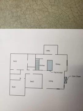

This is a ranch style with a full basement that is walkout on one end. Living space is 1500sf. The current fireplace is in the living room which is about 250sf (see attached photo) and is mostly open to the dining and kitchen. No budget at this time. This house has a gable roof on the bed and living room ends of the floor plan.
The good news is, there are lots of options. The not so good news is that ranch homes are hard to heat evenly from a fireplace at one end. The narrow hallway creates a dead-end pocket and restricts the flow of heat to the bedrooms. A wood stove in the current FP location would heat the LR, DR, and Kitchen adequately or maybe about 750 sq ft. If you want to changeover to a complete wood-burning system, the options are adding a woodstove at another location, or replacing the propane fireplace with a wood-burning fireplace, or removing the propane fireplace and putting a freestanding wood stove in the chase (if it is wide enough to meet clearance requirements).
Or... if the basement is insulated, a large wood stove could be put in down there, working out a heat convection method for it to heat upstairs, or put in an efficient wood furnace in the basement. Is the access to the stairwell on the hallway side or the kitchen side?
Locations for me would either be where the propane fireplace is or the exterior corner of the living room. Probably the corner.
Evan.
Do you have ductwork for the propane furnace? Perhaps a wood burning forced air furnace is an option.

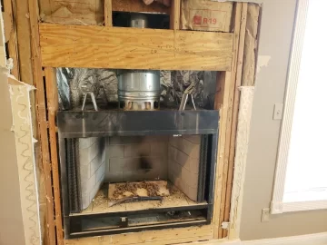

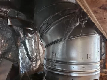

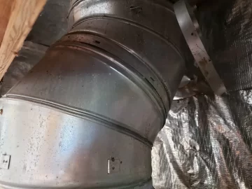

Sorry for the delay in getting back but yep, the options have been the problem. Seems I'm the only one keen on a freestanding wood stove. My better half thinks otherwise due to the real estate that it would take up. So, in a spirit of cooperaton (concession?lol) I'm looking into a wood burning insert such as the Ventis HE250. As mentioned previously I would be removing a propane insert that exists there now. So I figured I need to find out what I have as far as room inside the chase and, if nothing else, get rid of the gas stove. I exposed the chase and stove/vent and attached some pics. The vent looks to be about 12" and looking at the old stove specs it appears to be an 8" flue surrounded with a double wall at 12" (??). My dilemma.....disconnect the vent pipe and remove the stove without the chimney coming down. Not even sure about how this pipe goes together. Any ideas would be appreciated. Pics include the elbow coming off the top of stove. There's about 22' of pipe above the stove.
Thank you
[Hearth.com] Wood Stove Placement [Hearth.com] Wood Stove Placement [Hearth.com] Wood Stove Placement
Thank you
View attachment 281687 View attachment 281688 View attachment 281689
The gas fireplace uses a much different flue. You will need a new flue which is rated for wood burning.
