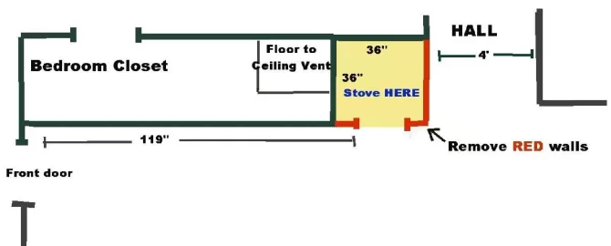

I have a 3' X 3' corner closet (outside corner) that I would like to locate a wood stove.
I have attached a 'not to scale' floor plan to better explain the situation.
The stove is primarily for back-up heat, so it wouldn't have to be large. I have wood floors and sheetrock walls.
I had a wood stove in my previous house and really enjoyed it.
Basically, I want to know if this space is sufficient and what would you recommend.

From what i see it looks good as you take out the "red walls" .
An over all layout of the house might change opinions but looks good so far.
Make sure your not taking out a supporting wall.
You "could" always put the stove in front of the closet where the door is and put the closet door on the hall side. { Just an option. }
Again with out seeing the whole floor plan its harder to make the "right call"

I think we would have to beef-up the ceiling. The hall wall is bearing.
It's the only spot I can come up with to put a stove.
We can't put it in front of the closet because it would crowd the front door entrance.
I just didn't know if the 3' x 3' space would be big enough.
Thanks for the replies. I will continue my research and hope to have something by next winter.

If the hall wall is a bearing wall then you will need a post at the end of it with a header above, probably a 4x12. is it 2 stories? You may have to use a metal post that close to the stove.
