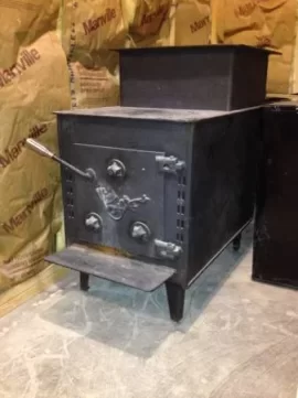

I have this medium sized non-ul stove. I want to use it in my new shop/greenhouse and activity room (man retreat). About 20' wide by 25' long.
Picture attached of stove. The 8" pipe is on the back of the unit. That little square party on top is a little heat box area in upper firebox. [Hearth.com] wood stove to mini-boiler and forced air shop heater
How might i do the conversion? What i need from it is a 2 to 6" flex ducting that comes out of furnace and will be pushed by the unit's existing fan, or upgraded blower. So i can supply heat by the tube to work projects or other side of greenhouse. Like a big hair dryer.

Can copper pipe inside the upper firebox withstand 1,000degree firebox temp this stove likely reaches?
Melting point of copper (if you don't have any joints in there that are joined with solder or brazing) is 1,984°F / 1,085°C per the internet, which is probably congruent with more official sources. If you don't keep the pipe full of water (which will keep it's temperature down in the 200F range) you will probably destroy it with scaling (oxidation) if not actual melting. Then again, having a cold element (which, from a fire's point of view, 200F is) too early in the flame path also serves as a collector of creosote and an impediment to complete combustion.
Thanks that is good to know! Is there a way to do this task that observes all the factors i need to? I want to make a mini part-time water heating source as well as have a part-time forced air output as well.
