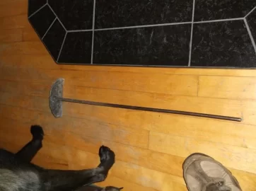

Got an old garden cultivator. Handle broke in half. Rounded the broken end and its long enough to reach the back of the stove and my hand don't get too hot anymore. Now I need to find a good ash shovel.
  • [Hearth.com] wood touching glass

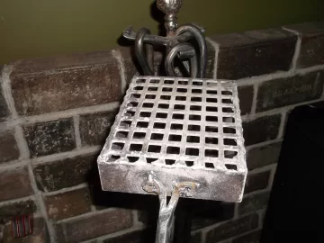

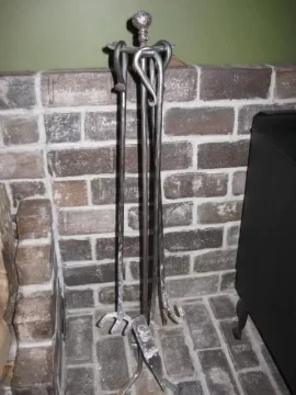

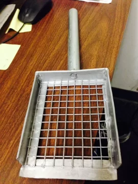

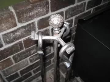

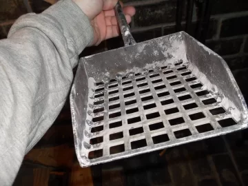

Some things I have made to make life easier. The rake is my #1 tool by far then the true shovel for getting ash out. The rest are petty much adornments and never get used much at all.
