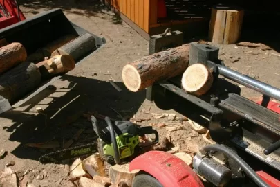

I burn in two stoves of different sizes, but I don't want to go to the trouble of storing wood of two different lengths. Splits of 16" - 18" are ideal. I consistently receive loads of splits or rounds from my regular suppliers that are just right. Occasionally I get wood from other places, and the length can vary from 12" to 24". The short ones just get stacked, but the long ones are a problem. Cutting 2" off the end of a 20" long 8" diameter round is sort of a scary thing. It finally dawned on me that I'm operating a gas-powered hydraulic wood vise (otherwise know as a splitter). Snug the round up nice and tight between the wedge & anvil, then safely trim off the end with the chain saw. I'll keep all the scrap and burn it in my shop stove. Now I can get everything neatly stacked in consistent and convenient lengths without doing some sort of frightening one-handed chainsaw trick or cutting my foot off. I'm sure this is not a revolutionary idea, I just thought I'd pass it along. Safe wood processing to all! Rick

Now thats a good idea, Ill have to try it out next time I have some long stuff.
Good idea Fossil. I think it would take more time doing it like that but may be safer. You must leave the splitter running all the while for this to work.
I usually lay one block on the ground, then lay the one I want to cut off on it and use the saw for a stop to cut it off with. Works well for me but sometimes the smaller diameter pieces tend to spin a little. If I really get frustrated I take them into my shop and cut them off on the 18 inch bandsaw. Works better but more of a hassle since they have to be carried in a couple at a time and returned.
Yeah, Carl...both the splitter and the chainsaw are running continuously while I do this. It really goes fairly quickly, as I'm not running the ram full travel, and I wait until I have a number of these trimming jobs piled up to do. If a round is too large to safely clamp, I split it first, then clamp & trim the splits. Safety is the key, I think, and I feel pretty secure doing it this way. Rick

Thanks Fossil! I tried your slick splitter trick (using it like a hydraulic vise) and it works like a charm!
