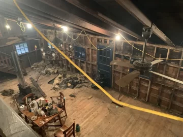

Thanks for the response. I did mention in the OP that while it currently has no insulation by the time we are done renovating it it will be fully insulated floor to ceiling as well as underneath the crawlspace beneath. I’m definitely considering the Progress as it is beautiful for sure. Guess I wondered if compared to the other Woodstock models for anyone who used them how performance for the 1600 sq ft would be. The great room is 18x35 and all upstairs rooms will have sliding barn doors to maximize air flow. Ceilings are very high. I’ll see if I can upload pics here.

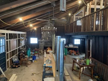

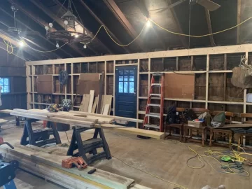

There are some better pics showing where the stove would end up going, ceiling height and overall openness of the space.
I agree the BK are ugly. Honesty not sure what to look for in burn time. Definitely want to be able to go to bed and not have to get up middle of the night. While I’d love to be able to leave for a full day and not worry about the pipes freezing I haven’t seen many models other than BK boast much more than 14 hours, so I’d suppose 10-14 would be a good range?
The Progress is definitely a big stove and want to be able to control temps so it isn’t roasting, I assume thats achievable by adjusting the thermostat on any stove?
