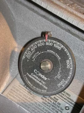

3 years ago I purchased one from Woodstock, they must still have them, it was made by Condar. I screwed it up when I scraped the crud off it with sandpaper.
I always thought that the screws that are on the back of the stove were for an optional heat shield. Did your probe thread into the hole or was it just placed in the screw hole?
The screw for the probe is right above the UL plate. Just remove and slide the probe in.
I bought my probe from woodstock about 4 yrs ago. I got the 8 inch and a shorter one for the flue. Look on page 31 of your manual. I will try to post a photo of mine.
  • [Hearth.com] Woodstock Fireview Cat question
This site has taught me sooooooo much. Thanks for posting the pics, TCintheOzarks. I would have bought one of those probes with the stove if I knew there was a location designed for using one. I did check on page 31 of my manual but that page nore any adjacent pages mention about the probe. I wonder if I have a different version of the manual. On the front cover of the manual it says Rev (revision) 0306. Any chance you could scan that page for me?
