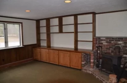

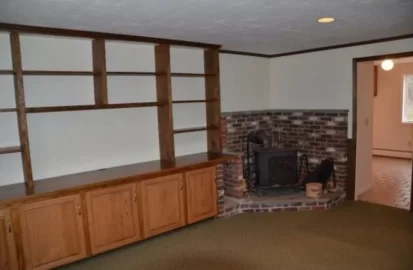

Here are some pictures of the room showing the old stove. I am not sure what brand the stove is but suspect it will either be moved to the garage to heat the shop out there or put on craigslist.

If you are expecting a 'flame picture' similar to a fireplace, you will rarely see that with the PH. Depending upon if the catalytic combustor is engaged or if the secondary is firing, the flame picture will change. Regarding the glass staying clear, it will depend upon how hot you are burning the PH and what time of year it is. I find that the glass will get somewhat 'smoky' during the shoulder seasons because the woodstove is not burning 24/7. During the regular burning season, the glass stays fairly clean all the time. Also, it sounds like the 150 sq. ft. room with the flat ceiling is going to be hot. If it is a primarily living area, you might want to consider other placement options for any woodstove that you install.
That room will get pretty hot with secondaries firing and unbearable with primary . Box fan blowing cold air into the room will help
Is that stove shown in the picture still in there? If yes, I would get that cranking one day and see how the temp in the room does versus the rest of the house. A small fan on the floor blowing cold air into the room may help getting the heat distributed to the rest of the house.
