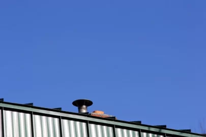

At 16 minutes I was at 700F CAT, and walked outside to check and no smoke at all...
