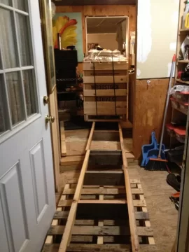

I moved my Progress myself twice within a year. From the Tacoma out to hearth, back in, then back out to a new hearth, stairs included. It's doable, it's all about leverage, lack of friction and - time. Heaviest thing I have ever moved but in no way could even remotely lift it [Hearth.com] Woodstock Progress Hybrid....any problems? .
