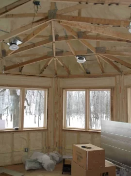

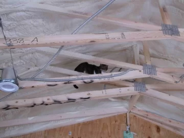

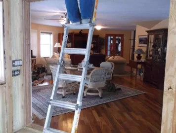

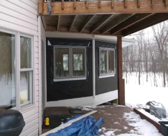

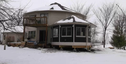

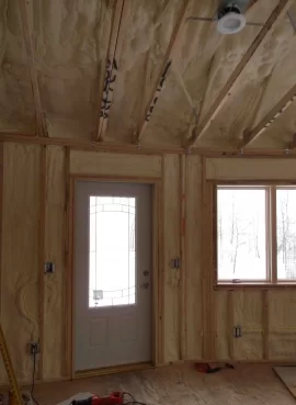

Just a follow-up posting. We're making "progress" on our add-on..and near ready to get our Progress stove. They say a new sale is coming this week....we shall see what's new! We went with an 8 foot opening to the main house, and are putting the ceiling duct work and fan in now. Outside temps have been bouncing around all winter - below zero, then up in the 30's like today. Heading back to seasonable in the tens this week, then bumping up again. Hope to get the siding on before the next wind-driven snow flies. We've been enjoying everyone's escapades on 'the hearth'. Great community. PS - MN landscape is pretty bleak right now... our place rocks once the trees leaf out. We'll be putting on a wrap-around deck to the new room addition once the spring rains subside.
