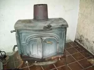

I am putting a woodstove as a back up heat source (although I plan on using it to supplement my heating costs) in the basement of my new home. I have built my home completely myself, except for the hvac system and drywall, and purposely had my hvac guys place the return vents right over top where my new wood stove will be to distribute heat throughout the house (hopefully). My basement is about 700 square feet (it is a walkout basement on one end of the house), but the rest of my home is about 2000 sq. ft. single story. My question is...how big of a stove should I buy to heat the 2800 sq. ft. total area of my house, but not run myself out of the basement? Am I dreaming...should I buy a small stove just to heat the basement and hopefully move some of that air upstairs to at least the end of the house over the basement? I was considering buying an old Vermont Castings Defiant to fix up and put downstairs. A lady is trying to sell me the one in the pics for 400.00. Looks to me like it would take a lot of work and $ to fix. Any suggestions on a great, reasonably priced wood stove that my wife would find somewhat aesthetically pleasing? I am in desperate need of all of your expert opinions!!

I'd take that stove for free.... not much more though. Without knowing more about your house layout its hard to say how well the heat would distribute. The return probably wont do a lot of good.

That old stove has burned hot and hard. I wouldn't take it, even for free. There are lots of good stoves to choose from, but you will get so much more comfort out of one if you put it on the first floor. If you like the looks of cast iron, then Jotul and Hearthstone make some excellent stoves. If you'd like an attractive cast iron/steel hybrid Quadrafire makes some and so does Pacific Energy. Then there are soapstone stoves which some folks love the looks of. All depends. All of these companies make their stoves in a variety of sizes so you can either put a small/medium one in the basement or a medium/large one upstairs.
That puppy has been overfired, and is worth more in scrap than anything else.
400 is too much for that old VC beater. Very Good stove in it's day- I had one in 1982.

I looks like a Vermont Castings Defiant if my eyes are right.
If it's solid and with good seams, a little steel wool and stove black would make it look primo.

Dear as they are to my heart, the Defiant in the picture is no real bargain at $400. It will need a complete rebuild. Labor (unless you feel you can do it yourself) and parts will add considerably to the cost. That's assuming none of the major castings are warped; if they are, it would be that much more expensive,
Nolev - that stove has been rode hard and put away wet. I think you will find better stoves for 400 bucks out there.

I have to agree; the stove looks pretty beat.
