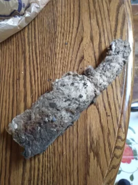

Hello, we have a new Hearthstone Heritage stove. We just cleaned it for the season. This material was sitting loose on top of the catalyst flap inside the top of the stove. It wasn't wrapped around anything. The only oddity we have had last season was two birds getting down into that pipe. Perhaps they knocked something loose. No other oddities. What is this material? Is it gasket ceramic wool, rock wool? Do we need to fix something before we can burn this season? It is a brand new stove installed last December. Thank you. - the wife. :)
[Hearth.com] wool material sitting on catalyst flap?
That looks like part of the rear insulation blanket. It is ceramic wool. Yes, it should be replaced.

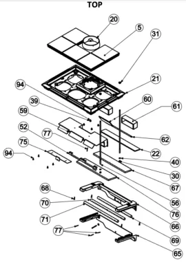

I haven't cleaned this stove but some folks are reporting that they have sucked up this blanket when vacuuming the stove after cleaning. It is listed as the rear baffle blanket (22) in this diagram of the stove.

I am still not sure why the Lehman's installer said isn't listed in the specs. The blanket is very clearly shown in the parts manual. Hearthstone publishes those manuals separately for their stoves.
begree, here is the owner's manual. Can you show me where that parts manual is in the owner's manual? I do not see it...hence the confusion on what to do with and how to replace the insulation blanket.
