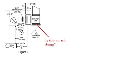

The attached is an excerpt from Simpson Duravent DVL series. The catalog shows a Tee with a cleanout at the bottom. Can an elbow be used in lieu of the Tee.

Sounds like it will indeed work, where as the smoke will indeed go up the chimney. But if you put a 90 in place of the T how is the rest of the chimney being support? And my main question is how would you ever clean it with out pulling out the stove?
Yeah, I am not an expert but I don't think thats legal.
Most building code dictates that a chimney shall have a cleanout.
Also, the Simpson/Dura Vent support bracket depends on using a Tee at the bottom. It will not attach to an elbow.
If I have to use the tee, can I add about a 6 to 8' straight extension to the bottom of the Tee and move the cleanout cap to the bottom of this extension? This would allow the cleanout to be in the basement in the water heater closet where I would have access. Obviously, this extension would be fire stopped where it went thru the chase floor.
I looked again at my wood burner Heatilator. It has two approx 30 degree ells back to back with a 3' straight in between - no cleanout.
