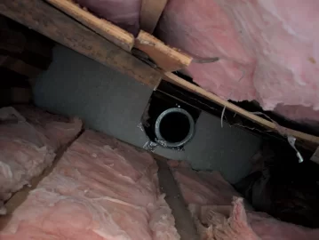

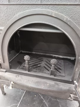

It's definitely 8" duratech from what I can tell, I've attached a picture. I can't go up through the house as there is a second story and this is on the main floor so will have to use a thimble and go out the side. The stove is actually brand new, bought it from an old farmer who had hopes of putting it in and never did.

Nope. That's not DuraTech. It doesn't have exposed insulation and the male end is different. I think new chimney pipe is needed.
Awesome find on the stove. It should work well.
