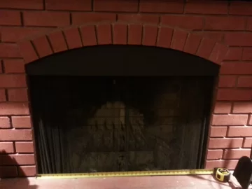

Not nearly enough info here to give you a yea/nay. Got pics?

What's the intended application? Have you confirmed that this appliance will fit your location?
Title corrected. Sounds like it might be a nice deal if the stove is in great shape. Not sure I'm excited about the used liner unless it is rigid.
my fireplace dimension are 40" width, 26" high to bottom of arch and 22" deep

my place in super air tight and well insulated. 1500 sf.

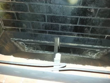

I would do the install myself, but not sure how to tackle the damper and smoke shelf. The actual flue is recessed back above smoke shelf. is this the normal anatomy of a chimney? Any Hints or tips welcome.
