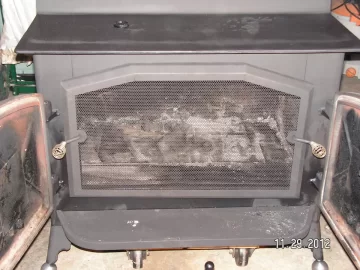

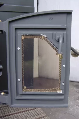

This shows the rectangle door sealing lip, the same size as on a square door to fit the seal channel. This is a Series III Glass that uses flat gasket material in door seal channel, unlike solid doors with no gasket.

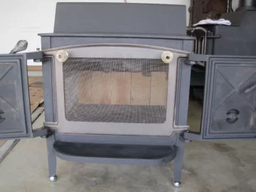

Here is a mis-matched screen for Cathedral doors on a square door. Notice the hinge ears do not reach down to the lower hinge plates to fit properly behind door hinge ears. This will not hold the screen tight to stove face.

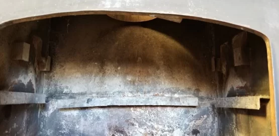

When a seller is claiming they are selling a Grandpa, if the door opening is arched, it is the coveted XL.
eBay 12-2013 3.jpg UT 6936 inside.jpg The XL is the only solid door stove that does not use the 1 inch channel iron door seal. (Series IV Glass doors use gasket on door with no channel iron seal) There is only a flat steel strip welded on edge to seal in the XL door groove.
