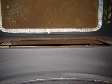

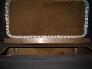

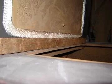

mishmouse, I too usually run the stove around 450-500. sometimes let it get up to 550-600 before engaging afterburn, depending on how the stove/wood is burning. is this too hot? never seen the stove get red or glow or anything obvious like that. I will try to post some pics next time i load some wood.
Not to discount that the lid is warped, but I had a puzzle with the lid on my Leyden. I had a little piece of park get between the lid and stove top and made it not seal like usual.
The lid would rock around a bit and first thought was "Oh crap how did this warp!".
So I pulled of the side panel and checked the gears out. The handle did seem to be a little more loose than it had been. Tightened things up a bit and did seem to help the lid seal better. Maybe this was the problem all along (I hope). But the top still has a bow to it. Maybe manufactured this way and Iam now just noticing it? Here are some pics. Maybe someone with the same stove can check and see if they have the same bow/warp. Thanks for the tip mishmouse about the gears definitely helped and yes my thermometer is about in the middle of the lid.

treehugger2 said:
The lid has pretty much the same bow to it.
Try posting a comment in the TL-300 users thread, there are at least 4-5 other users of this stove and that would be a good spot to post to get there attention.
As long as you are getting an air tight seal to it I wouldn't worry that much about it.
If you are still concerned just do the small fires to keep the chill out until you can get an expert to take a look at the stove.
Try this get a good fire going, close the primary air all the way and see what happens.
If you see allot of activity towards the top back of the stove that is not being caused by the secondary air intake then this could indicate a leak
On a side note it looks like you are getting a darn good burn with that stove. There is no black on the lid at all.
