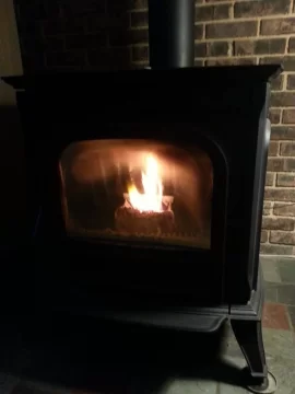

here is a pic right after the cleaning, will do another in a few more hours showing the stove after 10 hours. Hope the pic turns out okay.......

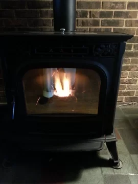

here is the stove at 10 hours (sorry for my legs in the shot!) but it does seem to be cleaner longer......will do a followup tomorrow evening with another 6 hours or so on it.

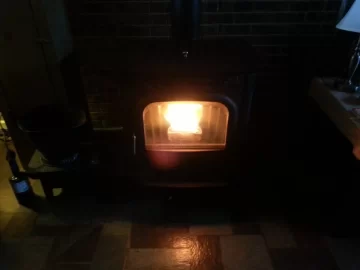

Here is 20 hours and a bag of pellets. Took a different angle. You can see the ash forming but not bad......how does this compare with others for similar time and look??????
