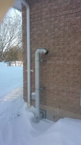

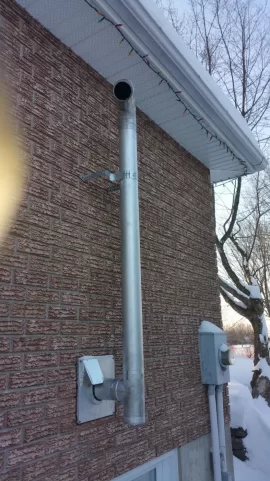

Can you provide pictures of the outside where the vents for each stove are?

Here are the pics
  • [Hearth.com] XXV may have to go
I'm no expert on this, but your setup looks odd.
LOL...then we'll let an expert comment on it I guess, unless you can explain odd;)
