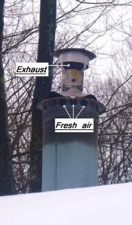

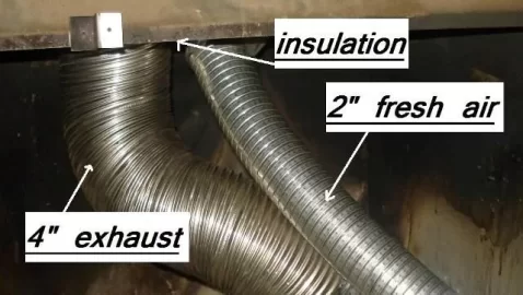

I went up the chimney, but not all the way. I insulated the bottom where the damper used to be, to prevent any cold air from coming down the chimney. The fresh air inlet is below the exhaust, so there is no problem. You can go all the way up, but not necessary. Check your manual, there should be some photos of optional installations.

I have a Quad Mt Vernon AE insert with an OAK. THe OAK is installed all the way up the chimney. At the cap, it is lower and directionally offset from the exhasut so as to not suck in smoke from the stove.
