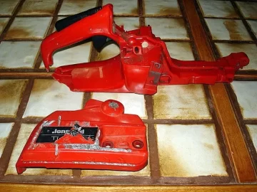

Pulled a boner earlier this winter. Had the saw up in a pile of 4 footers in the back of the truck, thought it was secure. I should have put it in the cab but it was kinda oily and smelly. Just got up to speed and the darn thing fell off the side of the truck. Smashed the handle and ground up the clutch cover pretty bad.
Cost just under $250 to repair that Jonsered. Guess what I'm getting at is $250 don't go far towards buying a good saw. Heck up here in Canada it will just fix a bone head blunder on a good saw!

Here is the Jonsered shrapnel......... When I took it to the shop, Earl told me he'd give her a good going over when he replaced the handle/fuel tank assembly.
When I asked him to replace the clutch cover as well he gave me a funny look over his spectacles and said "it just a saw!"............ I said "yeah but it's a nice saw",
he muttered something like.........."Why did you smash it then?"..................... What could I say?
Before leaving the shop I ended up buying another 2152c, a couple of chains, files and oil just so Earl knew that I don't mess around! Wow that was an expensive load of wood. Next time I get greedy and load the truck right to the nuts and there's no place for the saw in the back, I'm going to put that nice saw in the cab even if it's oily and smelly!!
