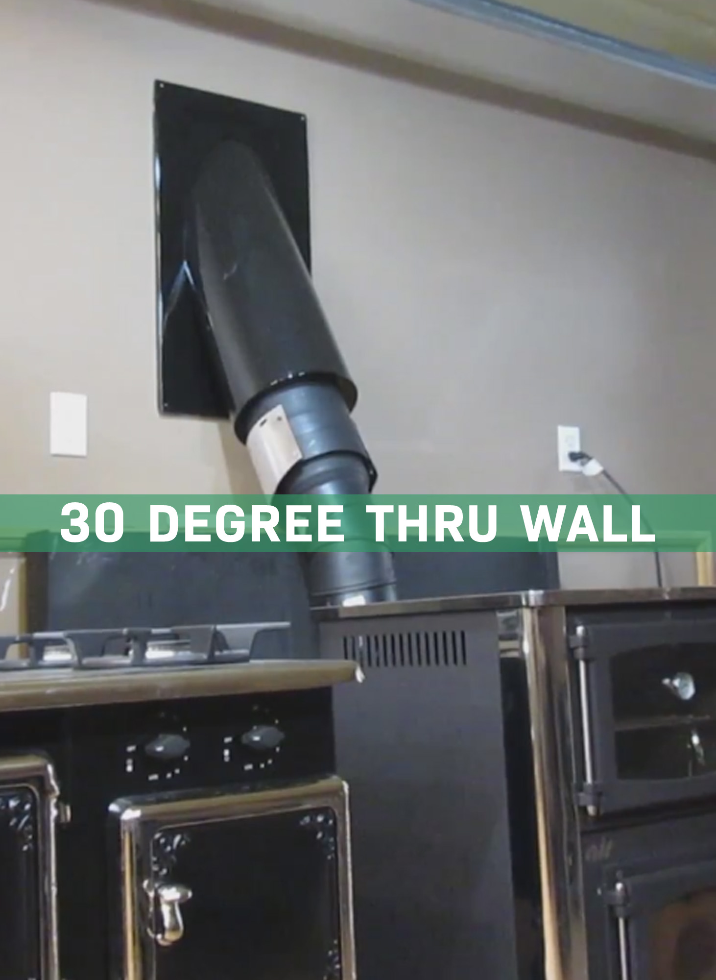

VA-WPT0630 - 6" Ventis Class-A All Fuel Chimney, 30 Degree Wall Pass-Thru, Non-Insulated
Are any of you familiar with this?
How do you think this would work with the Osburn Matrix, in the basement (8 foot ceiling), passing through concrete/cinder block wall
and then up.
When I first saw this 30 degree passthrough I thought (with my current grade school knowledge on all of this) that 30 degrees is better than 45 degrees (and both are way better than 90 degree turns).
On the outside I would hate to loose my T-pipe for ease of cleaning. I would be nice if there was a Duravent Class A component that allowed (maybe there is one but I can't find it) the Class A pipe running through this 30 degree wall pass through to connect to the Class A that will run to the sky above the clean out in the T-pipe.
Here's more info on it-
Your thoughts as always appreciated.
