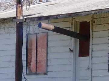

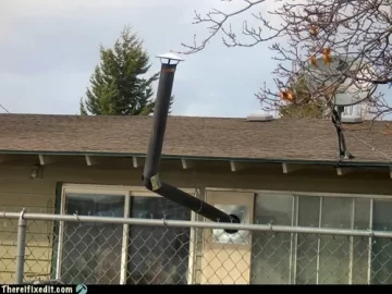

Must have been inspired by this installation.

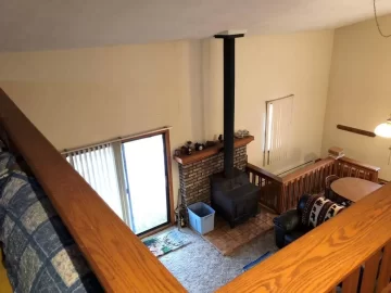

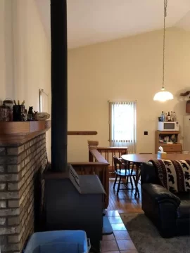

I was just browsing some real estate listings and spied this. They obviously burn it as there was a pic of a large wood cache in the basement. Gotta wonder how they get away with it like it is. It is a heck of a nice place. Great workmanship. There are several clearance violations going on here.
[Hearth.com] Your Thoughts on this Wood Stove Setup [Hearth.com] Your Thoughts on this Wood Stove Setup
Reactions: St. Coemgen
There is scorching on the mantel behind the stove pipe.
Yes there is. My thoughts are the clearance from the stove to the studs looks pretty close as well for an old stove. And the oak railing looks close too. And the hearth. Who knows if it is proper when you see all the other stuff.
Yes, 36" clearance required in all directions and 18" clear for single-wall stove pipe. Hearth is too shallow also.

Scorched wood = lowered flash point. New wood can take some heat, scorched wood will flash to flames at a lot lower temp.
Many people know that wood ignites at 450°F.
Many people don't know that steam pipes running at 200°F used to be a common cause of structure fires. (This may take years to happen at those temperatures.) Sufficiently pyrolized wood can apparently catch as a result of being exposed to temperatures as low as 170°.
