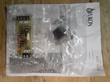

Finally parting with our Yukon Husky and will soon have parts available if anyone is interested to keep theirs going. Circuit board and solenoid working okay plus a brand new set I bought years ago but never needed. Used parts such as fan limit switch and other easily disconnected and shipped. Not sure how to ship heavy parts such as coal grates, bricks, blower/burner motor, etc. Would like to see as much repurposed as possible versus hauled off. Sorry no pot liner as I used my spare about 5 years ago.
  • [Hearth.com] Yukon furnace parts
Reactions: brenndatomu
