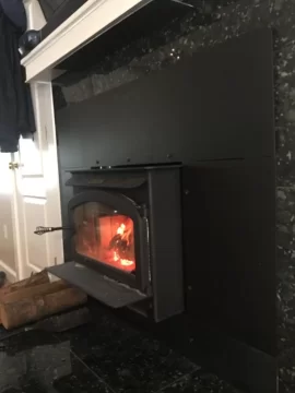

Update:
I was able to fit the Ironstrike Striker C160 into the existing ZC fireplace. Certified installer did installation. This "small" wood stove insert is more than enough heat for our modest 1300 sq. ft. home. The main room is only about 650 sq. ft. and what's nice is that I can keep a smallish fire going which keeps the stove in a good temperature range and it doesn't get too hot in the living room. But it does get pretty warm! I'll know more about how well it heats as we get closer to winter but I'm optimistic.
We went back and forth about trying for a larger stove and I'm glad we didn't end up with one. This stove fits our existing hearth perfectly, and with the addition of a MEECO'S RED DEVIL 5050 Mantel Protector we should be in good shape for our final inspection.
Very excited to actually heat our home instead of feeding a useless fireplace!

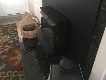

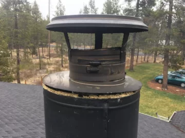

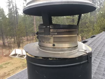

Yes it was a compatible model of ZC fireplace as stated in the installation paperwork. Unit was inspected and certified by the county as well. Not sure if "cooling vents" were obstructed, or how to confirm this post install. Installer is coming back to redo a chimney cap job that was botched up. I inspected it when I was putting up some Christmas lights over the weekend. I can ask him about that...

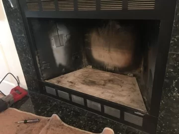

I did cover the ZC vents below the fireplace opening with a piece of sheet metal because they looked like crap and I wanted it to look finished. They were part of the ZC fan/blower system but didn't seem to move any air (I did a kleenex test on the vents with the fan running before and after the install and air flow was miniscule.
You can see the lower vents in the before pic. The top vents were covered with the surround piece that came from the manufacturer but there was no surround piece for the lower part. Just as an additional note I sent the mantel shield that I bought online back to the seller (it was flimsy and banged up) and had a piece of sheet metal customized which works terrific. The inspector was satisfied with all of it.

Ok well it doesnt matter if it passed inspection or not your install is unsafe. You cannot block airflow through the cooling chanels of the fireplace or block airflow through the outer passages of the air cooled chimney. You really really need to address these issues. It is very dangerous as is.

And does the fireplace manudacturer allow inserts to be installed in your fireplace? You need approval from both manufacturers.

I also see that the inner refractory panels were pulled out that is another big no no

And lets see the instructions for the fireplace. I am sure it doesnt say you can remove any of those things and maintain the ul listing which is required by the insert manufacturer. But regardless of the legality of it just think about it. That zc box is just 2 or 3 layers of sheet metal with an airspace that is cooled by the airflow around it. And the heat is also controlled by that refractory panel. You have just eliminated the only things keeping heat off of the adjacent framing. Which was also done to the air cooled chimney. It is extremely dangerous.

Very dangerous set up, with blocked vent holes and refractory plates removed, the zero clearance stove essentially became a hot metal box that's against combustible walls, even though the zero clearance stove walls may not be hot enough at first to start a fire, overtime through pyrolysis you will be at a dangerous / greater risk.
Also the existing chimney, even though it has a liner with in it, is it a true class a pipe? Some of the builders grade zero clearance units used chimney pipe that doesn't meet the code for wood stoves / 24/7 burning, also I'm pretty sure any clearances / protection that the old chimney pipe provided before the liner was installed in it are gone since the top plate that clamps around the new liner is also covering the air gaps of the old chimney pipe.

No it is an air cooled chimney that looks like it has insulation stuffed in the top of the cooling passage and is then covered with a plate. Another very dangerous modification
