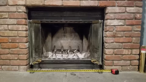

I attached a picture of the existing fireplace. Its 38 wide and 31 tall. It's a pretty generic piece.

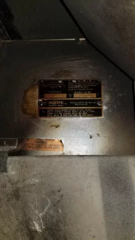

Not all ZC fireplaces permit insert installation. Look for the manufacturer and model info. It should be on a metal tag on the frame. Let us know what you find.
Most insert manuals say whether they are for masonry only or also approved for ZC (metal) fireplace installation.

Without knowing what make/model your current "generic" ZC fireplace is, I can't answer that question.
Ok. I'm pretty sure I have a stainless 8inch chimney. I imagine the install would be a 6 inch flex coil run down the opening from chimney cap down to the junction on the "insert". So then the install should be simple from that perspective. For my understanding, let's refer to a drafty open box as a zero clearance fireplace and a sealed controlled burn chamber as an insert. I want to remove the zero clearance fireplace, and install a sealed efficient "zero clearance" insert?
I checked out the flame monaco. It looks like a more efficient version of a conventional zero clearance fireplace. You're saying this type is my only option and I can forget about a proper insert like a Vermont castings merrimack?
Yes it is very likely that an insert is not an option for you. But to know for sure we would need to know what make and model your fireplace is
Majestic rc36
Looks like no insert allowed.

So I'm experienced with wood burners. We have a stove, and I recently installed an insert into an old fireplace at the family cabin. I absolutely love them and have been gathering dozens of chords since I would swing a chainsaw.
I bought my first home, and immediately the fireplace drew my attention. I know all the costs and benefits of wood heat, and I'm convinced I want to do an insert here. Though I wont do the install myself here for the liability issues. My question is, what inserts are rated for zero clearance??? Its hard to find this on manufacturer's manuals.
Also, for my piece of mind, is it advisable to line the opening in the ZC fireplace with durok and roxul?
