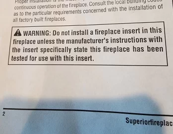

An insert is considered an accessory. They are not allowed by the manual for their specific fireplace. The only way around it would be to get majestic to give a written addendum to their manual.
Very few prefabs allow inserts and supposedly ul is rewriting the standard so none are allowed unless they are specifically tested and listed as a unit with every part specified.
Most superior fireplaces don't allow inserts either

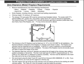

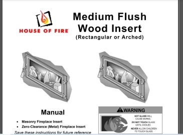

That makes sense obviously... UL writing the standard.
Wonder why my Superior allows it.

Apparently my Superior allows it.
