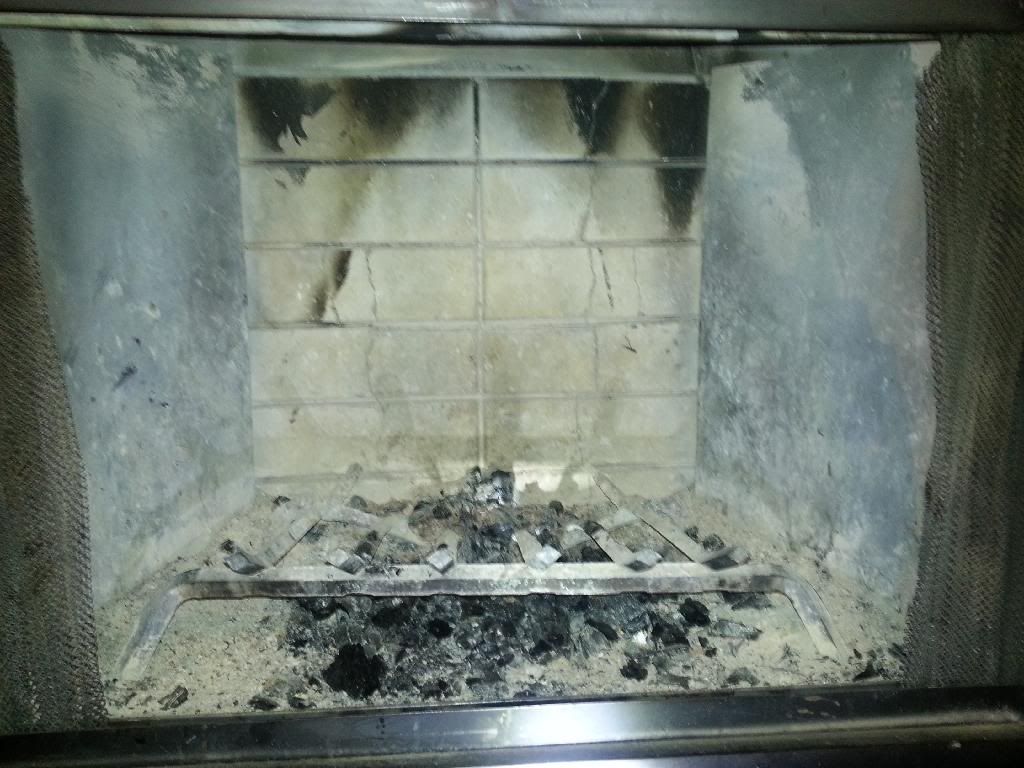

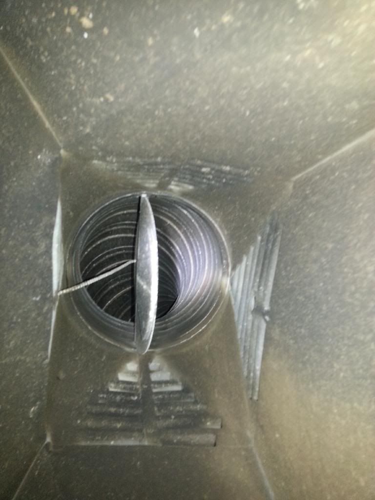

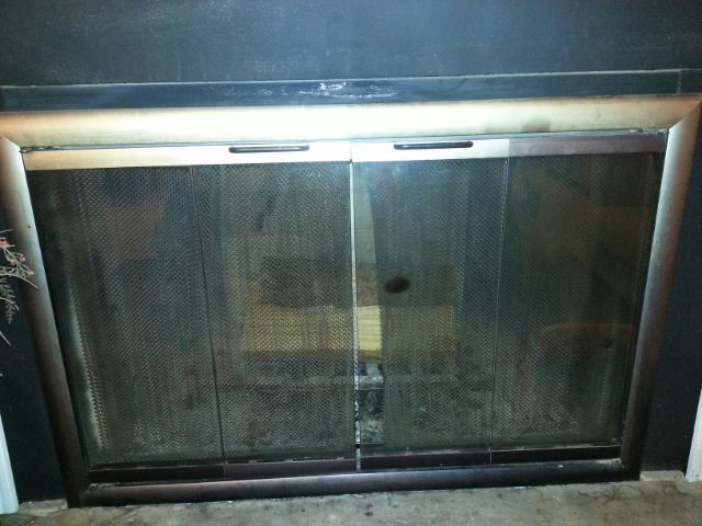

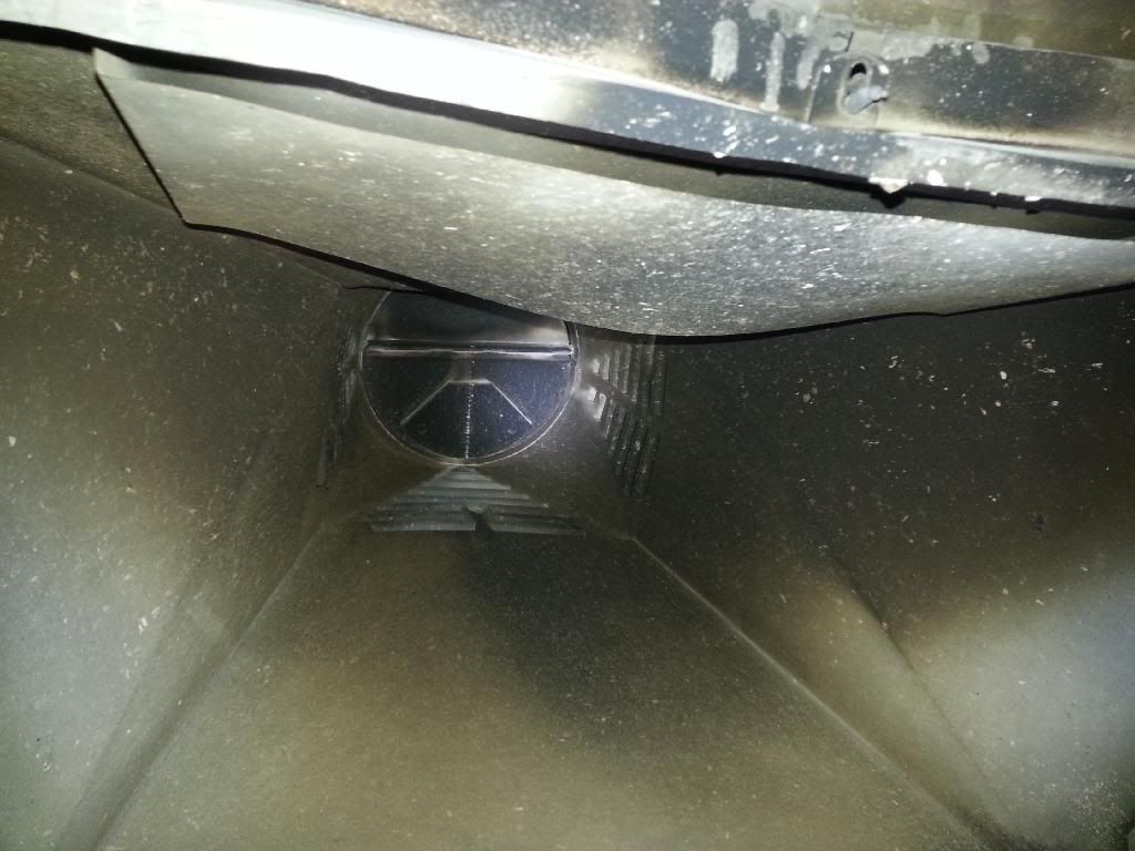

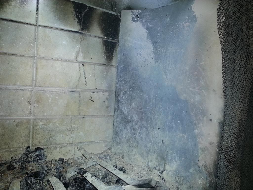

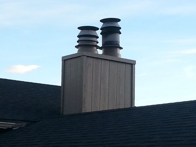

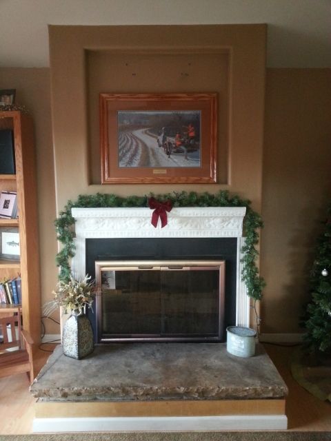

Pictures of my current ZC:

Great pics of the unit itself. Stand back a bit and take a few pics of the unit from floor to ceiling (and anything interesting inbetween). That may help a few of the folks who know their stuff give you additional advice.
Also, when light permits, what it looks like from the roof up to the sky.
I'm not expert here so not saying these shots will help me give you a better answer, but may be helpful to other knowledgeable folks.

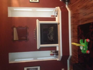

He is a litte better view..... The more I read about the ZC fireplace the more I like them. A little less efficient but seems to be a no question asked safest route. Just might not happen this winter, have some more pressing things to on the new digs.

Doesn't hurt to start shopping at the end of the season. Sometimes you can get deals on inventory they were hoping to move before new stuff comes in over the summer.
To me though, a deal would only be on the perfect insert for your situation. If you compromise for say a smaller unit because it's a good deal, you stand a good chance of never getting the performance you were hoping for and might have a good deal end up being not so sweet in the long run.
And I agree that keeping it zero clearance is probably the easiest thing to do. There are some good units on the market from what people report.
