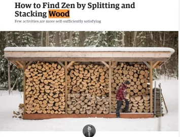

Scroll about halfway down the link.
[Hearth.com] Zen & the Art of Wood Heating

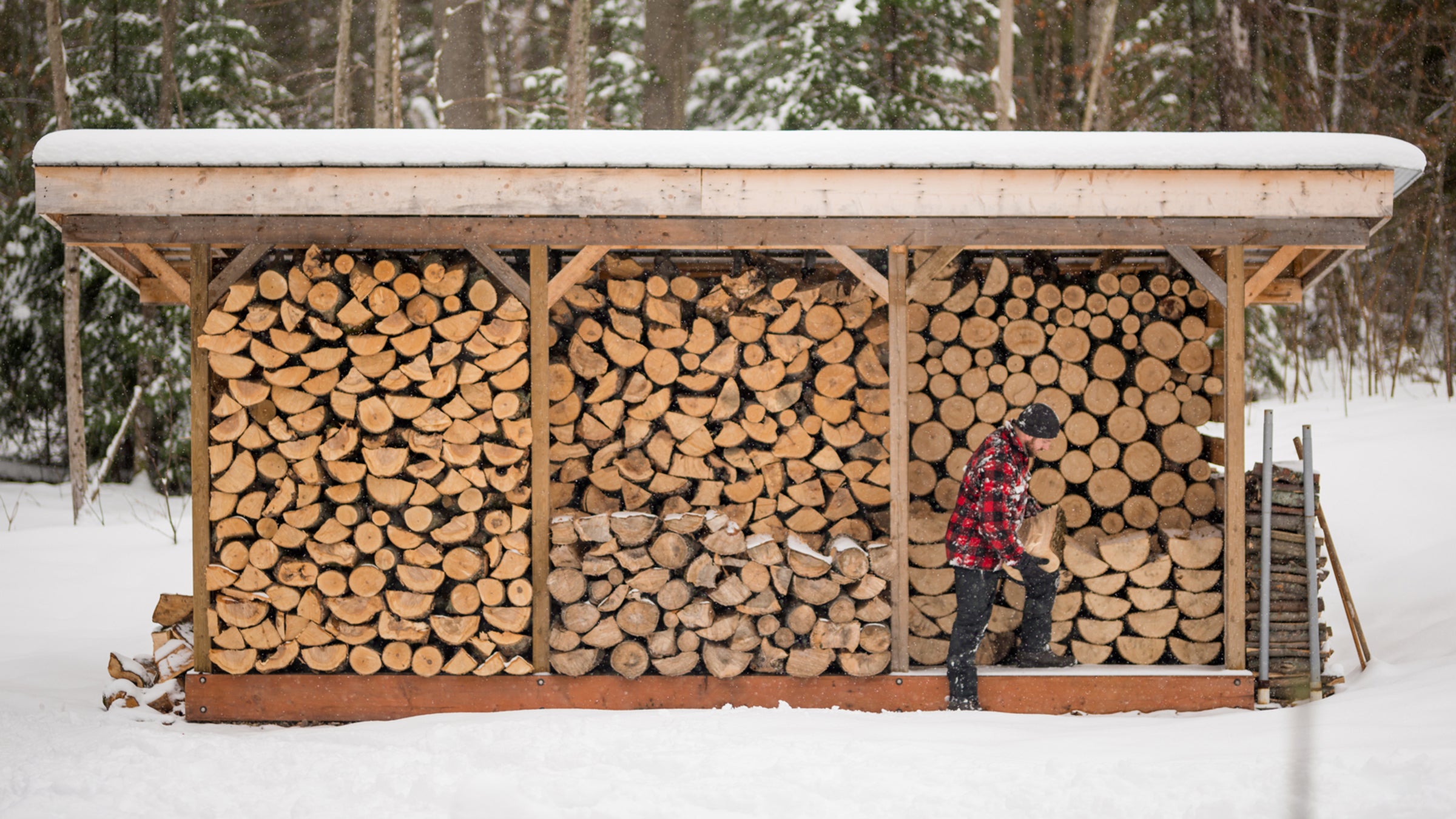

Now I can understand how wood stacking could be like meditation and look at that wood pile--lots of work there...I have a question? Is it possible to spray a wood pile with something to deter the bugs without hurting people when the wood burns..? I am thinking of building a little wood shed for a small amount of wood and do I leave it open somewhat or close it completely?..Of course this is after I like my stove and this could be in a few years of burning a little wood to get used to it...How many years of drying is wood considered good?..Just thought I would ask now that the wood subject came up...I wonder how long it took that person to chop all that wood? Lots of it..How many cords would that be--I am guessing----just guessing here---maybe about 8...thanks ..in time I will read the whole articles that I am interested in but right now don't have time...clancey

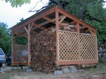

Do you have pictures of your shed somewhere in the forums?

It's simple but gets the job done. Holds 3 cords per side.
Thanks. 3 cords per a side, so use a side each year with a 2 year rotation?

One side gets whatever hardwood I accumulate and rack dry for a couple years at another spot in the yard. The other side gets green doug fir in March/April. By Nov. 1 it is in the 18-20% range. By Jan. it usually is at 17%.
