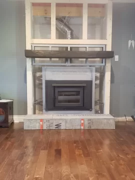

Well I went with the Montgomery 75 for local availability and Black Friday cost savings, plus local installer came out to give advice and will be doing a pre install visit after I do demo/framing. The demo is done and i am reframing ths opening as well as building a raised hearth, the previous stove was on the floor. Next step is, I am looking to do 2x4's on side with plywood, Duroc and stone on top with insulation between studs to give me the roughly the 6" raised hearth I'm looking for. Question. Do I need to stone the area where the stove will sit, or do you make a raised area with framing for the stove platform so that the hearth in front of the stove will be level with it once the stone is applied? Second question. Does anything I'm doing need changed? Steel or metal studs? Fiberglass or Roxul insulation?
Thanks in advance, the family is pretty excited to have wood heat again.
No, you don't need to carry the stone all the way under the fireplace. Download the manual for installation instructions.
The WFP-75 may be installed directly on the floor or on a raised combustible or non-combustible base (see figure 5). That base must be at least equal (or exceed) the height of the floor protection. For more information regarding the installation on a raised base, refer to the “Hearth Extension Requirements” section of this manual. Please take note that a minimum of 80" (203 cm) measured from the base of the appliance to the ceiling is required (see figure 6).
