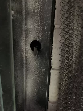

Post a photo, someone here will probably be able to ID the manufacturer..
Thank you, house was built in 2005

Open the doors and look in the door channel for a metal ID tag.
I didn’t find a tag but you inadvertently solved my problem! I opened the glass doors and found a damper lever that closes off the outside air. So I assume it works just like a damper on a wood stove. I was able to see a tag on the inside that said hearth and home company. I’ll do some research on them since I’ve never heard of them.
Thanks all for the help
  • [Hearth.com] Zero Clearance Fireplace and outside air
Good find! HHT is one of the biggest in the industry. Most likely this is a Majestic or Heatilator brand fireplace.
