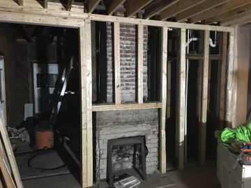

Here is the space I am dealing with. We don't want to use the fireplace thats there because it is too small and too low. I want to put in a zero clearance in the space to the left and then just tie into the chimney. Does anyone have any ideas? [Hearth.com] Zero Clearance into a brick chimney?
Your only real option for this space would be to cover over the old fireplace opening, and install woodstove in front of the fireplace. This would require a full SS liner and a new thimble about 6' feet from the floor.
Your options are to do what webby said and install a stove with a liner run through that chimney. Have the existing fireplace brought up to code and use it that way (which may or may not be possible). Install an insert and liner which again may not be possible in that fireplace. Or tear it all out and start from scratch with a zero clearance unit. There is no way at all that you can use that chimney with a zc unit it cannot be done.

While you are renovating you have a great opportunity to rebuild that fireplace as a masonry alcove for a wood stove, even if you have to reposition some of your new framing to accommodate a protective back wall. Extend your hearth and you can still maintain the look of a fireplace behind the stove, you almost have a clean slate. That chimney looks like it was built well and seems to be a good candidate to be used with a stainless liner or what has been suggested already build protective back wall in front of the firebox and install a thimble above your existing fireplace. Of course you could also line the chimney and restore the existing fireplace if you are mostly only interested in the ambiance of an open fire, that will also be easier to do with the chimney exposed as it is. That is not an unusual size fireplace for an old home though if your renovation produces a large room it may look odd being so small, I bet it draws well if the smoke chamber was built properly.
Actually that looks more like a coal fireplace than one built for wood and if that is true the flue may be pretty small many were. If that is the case it may be very hard to fit in a liner for a stove much less one for the open fireplace. We really need some more info to know what the options are as far as lining it

The fireplace is tall and narrow. It looks like there may be an opportunity to put in a rear-vent stove there connected to a 6" liner. That type of installation could finish off very attractively if this is the case.
@Arrowoods What are the dimensions of the fireplace opening (and depth)? What are the dimensions of the chimney interior?

Danke, I missed that. That could make a rear-vent stove possible as the most affordable option.
The poster stated that the flue is 9 X 14. What is there seems to be a great start for a stove set up.
Ahhh I missed that one A stove liner would work then not sure about one for an open fireplace
