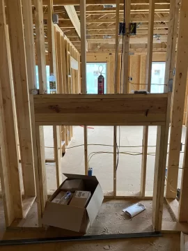

This is what I’m working with, I’d like a wood burning fireplace that would fit without burning down my house.
Ok so you need a zero clearance fireplace of some sort. Are you looking for heat or just aesthetics?
Regardless most of that framing will need pulled out and framed to spec for the fireplace you pick

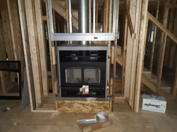

Attached is a photo of my Osburn Strattford II just installed in new construction. R.O. 24 7/8"d x 37 3/4"w x 41 5/8"h. Note the steel studs above.[Hearth.com] Zero Clearance ?s
