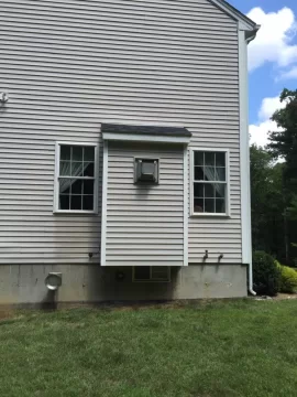

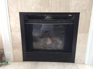

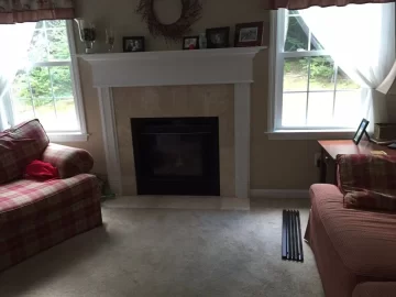

i currently have a propane fireplace. It's cheap and the flame looks fake. We used it for a couple of years until the propane company charged way to much per gallon since our useage was low. We used it occasionally. I decided I wasnt going to pay over 300 a year to run the pilot most of the time.
I was looking into zero clearance fireplaces, but with my existing set up, I'm not sure if I can do it or it is worth doing. I wanted to go wood because I have plenty of it in my yard. I currently have 2-4 cords of split oak sitting on pallets. Right now we use it as camp firewood.
I was looking to to supplement our existing oil furnace/ hot air. My wife likes to keep the house cool and I just want warm it up a bit when she is not home.

The propane installation doesn't have a full chase going up past the roof for a chimney and it looks like it lacks the depth for proper wood fireplace and chimney clearances even if a chase was added, but that would have to be measured to verify. To replace with a wood fireplace it might require demolition of the current setup and starting from scratch. Another option is to go to the gas forum here and enquire about replacing the pilot with a pilotless ignition system. Or consider another location for a wood stove.
Just a terminology lesson to make your searching easier. Zero-clearance fireplace is essentially a "stove" with a number of shrouds/shields around it to be able to be placed immediately next to combustibles. An insert is a stove without the shields and shrouds that is made to be placed inside an existing open fireplace.
You will not find an insert that is listed to be put inside any zero clearance fireplace (your LP fireplace is also considered zero-clearance). You will have to entirely replace the LP fireplace. The number of EPA high-efficiency ZC fireplaces on the market is limited so your odds of finding one to fit your opening perfectly are pretty slim. The scope of the project will depend what exactly is inside your enclave/enclosure.
Regarding chimney: you may be able to g right up through that little roof but it looks like it may be tight to do properly. You could also build that chase all the way up to the roofline to make it look less cheesy.

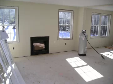

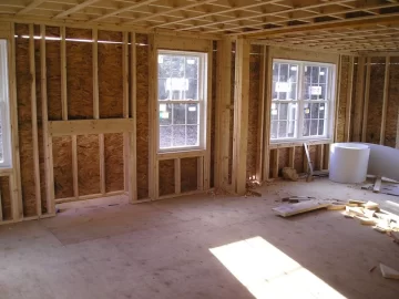

I took some measurements. The exposed part of the fireplace between the tiles measures 34W x 32H. The chase on the outside of the house sticks out 23 inches from the siding. I found of pic of whats inside there when the house was built. Its just wood.

Thats going to be a tough one, I doubt you'll find a wood-burning zc to fit an opening that size. So if you want ZC you're going to have to open up your wall and change the opening size (structure). Is the 23" dimension from surface of siding to surface of siding? If so that means the inside dimension from surface of the wall to surface of the wall should be similar Unless there is a wall thickness difference; is your main wall 2x6 studs? Tough to tell from the picture angle.
If you "bump out" into the room a little you can be ok on the depth, height and width is the problem. For example, the Kozyheat Z42 that I have is 38" high, 42" wide, and 26" deep. It looks like your chase has the room to expand the opening size to the top and sides, you just have to move out the structural supports in your wall and get a longer header over the opening.
